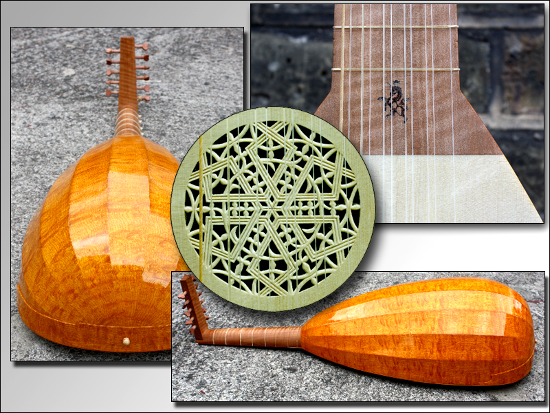

kr236rk
Re: Lute strings?
Postby kr236rk » Sat Oct 18, 2014 11:05 pm
That's great - thanks :)
Found a picture of a six course so wondered what the tunings were:-
http://www.lutesandguitars.co.uk/images/MI54%206c2.jpg
from
http://www.lutesandguitars.co.uk/htm/cat01.htm
