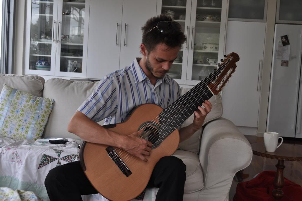

I can't help you with a Brahms guitar, but I did make this Alto recently. If you were anywhere near Musikmesse the owner will have it on display this year. It worked very well regarding tuning I believe. If you want to ask general questions about multi string guitars email my 10 and 11 string representative Peter Mony of Laudarra guitars
He has experience with a range of these kinds of instruments...I don't know much about fan fretted guitars but I can't imagine it would make tuning easier if that is something you are focused on. Normally my impression is that these guitars are set up fairly low which makes tuning a little simpler, as opposed to active instruments with high action in the classical world. I could be wrong here...

Lance Litchfield wrote:I can't help you with a Brahms guitar, but I did make this Alto recently. If you were anywhere near Musikmesse the owner will have it on display this year. It worked very well regarding tuning I believe. If you want to ask general questions about multi string guitars email my 10 and 11 string representative Peter Mony of Laudarra guitars
Ah, that's a beautiful Alto, Lance. That's quite the extended armrest you have on it - would you like to comment on that? Have you build many of these?
What is the string length and how are you tuning it? And what string are you using for the highest pitched string (an A 440?) - that is, brand and material of the string?
Is there now a standard tuning for Altos or is it everybody's personal choice?
Re tuning - six or more non-linear tuning systems sided by side stretched on the procrustean bed of the frets - and then stretch it out in a fan - I would want some extra material in the saddle and nut so as to have something to cut on to make adjustments - and yes, as my consciousness about tuning has gradually increased over the years, I finally did realize that the higher the action, the more unpredictability due to the stretching of the strings, and so I have brought the action down on my guitars to about 3.3 mm at the 12th and now play more softly... in about 1973 the first thing my first teacher said to me was, "you're going to have to play louder than that if you're going to be heard in the back of a concert hall," and that sent me off on a path of many years of pounding on the guitar with super rest strokes and raising my actions up to almost 4 mm ... glad I finally got over that.

jack_cat wrote:Ah, that's a beautiful Alto, Lance. That's quite the extended armrest you have on it - would you like to comment on that? Have you build many of these?
Thanks Jack...no, this is my first, hopefully of many to come. It was undoubtedly the hardest guitar I have ever made, but it did turn out very well. Peter tells me it is "perfect" and wouldn't change a thing, which is good as he is very particular. I couldn't have done it without his specialist expertise, from which I have learnt a lot from. I found myself constantly having to go back to original calculations on the scales and measurements quite often as I would lose track of details, compared to the standard 6 string simplicity. Yes the arm rest is on the longer side...personal preference, and also to allow different seating and arm positions, given you never know who will play the guitar. This guitar is tuned 11-1, Bb C D Eb F G C F Bb D G. So the 1st not at A. The scales are based on 625.48 which is the best template for that scale I had for the slotting machine I used...the first 7 ended up 556 from memory. The longest 743 ish. The concept of these kinds of guitar from what I understand was designed around the use of normal guitar strings. The first 7 is like playing with a capo on the 3rd. Really though, there are no rules if someone was to experiment with different strings or tunings, it is just the market for this kind of instrument is classical/earlier music...talking to a friend in Sweden about his modern music and his archlute, he tells me modern composers love them, so why not the alto11 I think. I couldn't say if a different string would work but if you ever find a nice option let me know! It's only 2 frets from the standard G so you'd think it wouldn't be too much trouble.
Yes, fine tuning the tuning is tricky, and even changing brands of string or settling in of the guitar can cause issues. Like mentioned before, I don't have any direct experience with fan frets but when building I try to minimise variables I can't control where possible. Hence the use of a good fret slotting machine, sticking to the same strings etc. Keeping your action low would be one of those if I was able to. Sounds like you have a grasp on what works for you.
